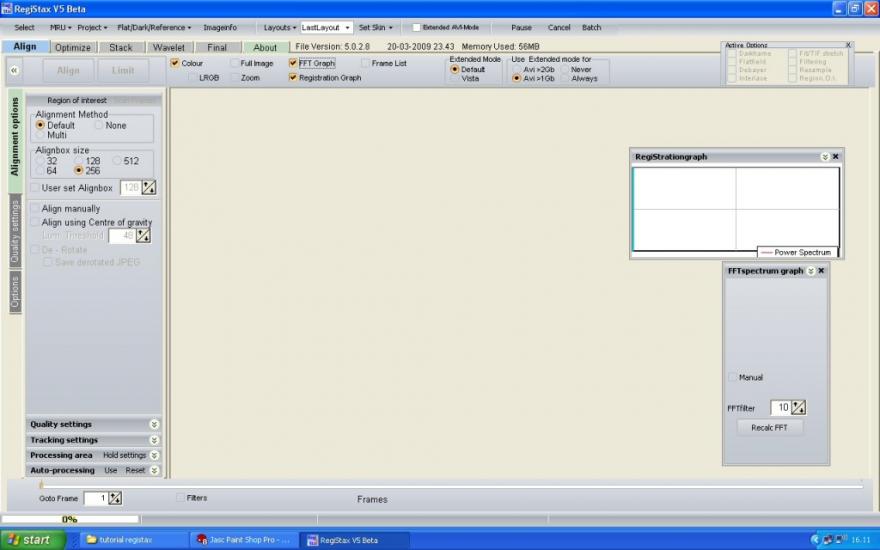

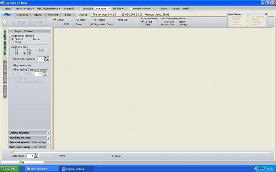

INIZIAMO CON L'APRIRE IL PROGRAMMA REGISTAX:
DOPO APERTO VI COMPARE QUESTA FINESTRA.

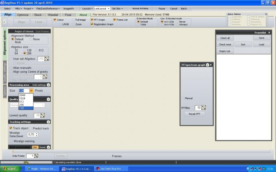

Allegato 4574
COME POTETE VEDERE, ALLA SINISTRA C'E' IL BOX DI ALLINEAMENTO,DOVE HO SCELTO 256, OTTIMO PER GIOVE E SATURNO E LA LUNA,
INVECE PER VENERE E MARTE,CONVIENE USARE UN BOX PIU' PICCOLO COME 128.

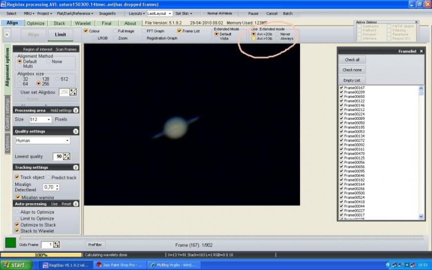

ORA NELLA BARRA IN ALTO, (SE SI E RIPRESO UN FILMATO A COLORI) SI SPUNTA COLOR, A DESTRA INVECE SI SCELGONO SIA REGISTRATION GRAPH,CHE FFT GRAPH.PER QUANDO RIGUARDA IL RESTO PUO' RIMANERE COSI'.
DOPO AVER FATTO QUESTE MODIFICHE, VI TROVERETE IN UNA SITUAZIONE DEL GENERE:

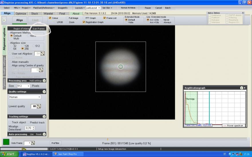

COME POTETE NOTARE SI SONO APERTE DUE FINESTRE UNO E REGISTRATIONGRAPH,E L'ALTRO E FFT GRAPH. A QUESTO PUNTO,DOBBIAMO

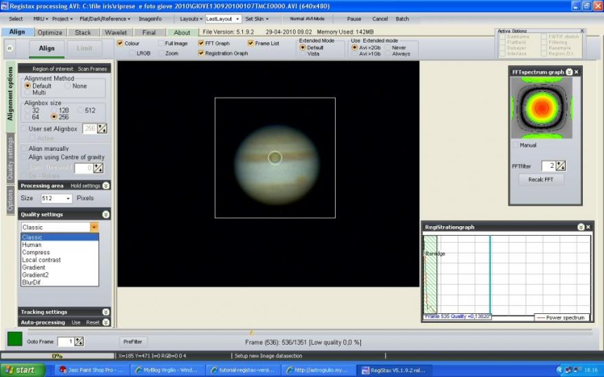

ANDARE A SINISTRA PER ALLARGARE IN ALTO LE 4 FINESTRE,QUELLE CON SCRITTO ( QUALITY SETTINGS,TRACKINGS SETTING,PROCESSINGS AREA,AUTO PROCESSING).COME POTETE VEDERE NELLA FINESTRA QUI SOTTO,CI SONO TRE FINESTRE APERTE,(QUALITY SETTINGS,TRACKINGS SETTING,E PROCESSINGS AREA),INIZIAMO A VEDERE A COSA SERVONO QUESTI TRE PARAMETRI.
IL PRIMO PARAMETRO,(PROCESSING AREA),COME SI VEDE NELLA FINESTRA QUI SOTTO,HA UNA SERIE DI IMPOSTAZIONI A PARTIRE DA 128 PIXEL FINO A 2048 PIXEL,QUESTI PARAMETRI INDICANO L'AREA TOTALE CHE REGISTAX SCEGLIE COME RIQUADRO DI ELABORAZIONE.

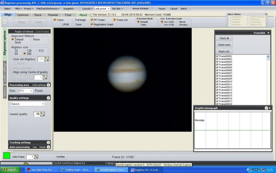

A QUESTO PUNTO SE RIPRENDIAMO I PIANETI POSSIAMO IMPOSTARLO ,(COME FACCIO SEMPRE IO),A 512 PIXEL,INVECE PER QUANDO RIGUARDA LA LUNA CONVIENE SCEGLIERE TRA 1024 PIXEL O 2048 PIXEL (MEGLIO 2048).
Allegato 4576

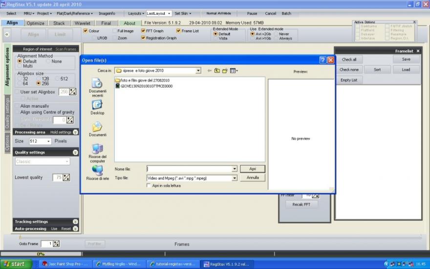

Allegato 4577

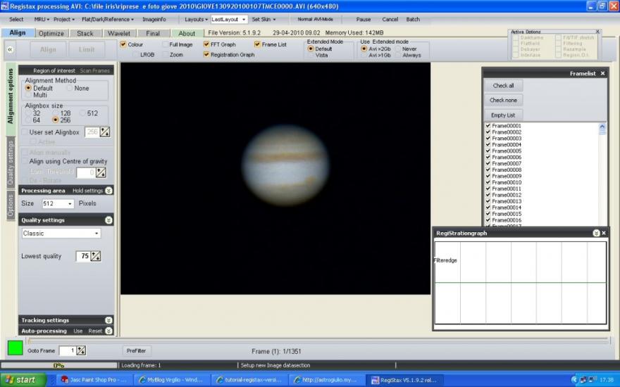

DOPO AVER APERTO IL FILMATO,VI SI PRESENTERA' UN RIQUADRO COME QUESTO.
Allegato 4578
GIUNTI A QUESTO PUNTO,REGISTAX HA SCOMPOSSTO L'INTERO FILMATO,IN UNA SERIE DI FRAME.ORA SE VEDETE SOTTO C'E' UNA BARRA ORIZZONTALE,CON UN CURSORE GIALLO, QUESTA BARRA RAPPRESENTA TUTTI I FRAME DEL FILMATO A PARTIRE DAL NUMERO 1 A SINSTRA FINO (NELL'ESEMPIO QUI SOTTO),AL NUMERO 1351 A DESTRA.IN BASSO ALLA BARRA ORIZZONTALE REGISTAX CI INDICA ANCHE CON LA SCRITTA
(SEMPRE NELL'ESEMPIO) FRAME (1): 1/1351.
QUESTO SIGNIFICA CHE STIAMO VEDENDO IL PRIMO FRAME DELLA SERIE DI 1351.
Allegato 4579

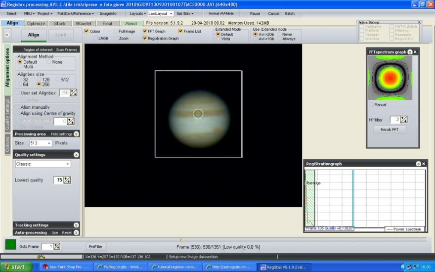

ORA FACENDO SCORRERE IL CURSORE LUNGO LA BARRA ,DOBIAMO CERCARE IL FRAME MIGLIORE E MENO DEGRADATO DAL SEEING,
FATTO QUESTO,PUNTIAMO CON IL MOUSE IL CENTRO DEL PIANETA,APPENA VI AVICINATE VI COMPARIRA UN RIQUADRO BIANCO,(A SECONDA DEL IMPOSTAZIONE FATTA SUL BOX DI ALLINEAMENTO,SPIGATO SOPRA),SARA DI DIMENSIONI PICCOLE O GRANDI,NELL'ESEMPIO DI QUESTO TUTORIAL VEDI FOTO SOTTO HO SCELTO IL BOX DI ALLINEAMENTO IMPOSTATO A 256.
CME POTETE SEMPRE VEDERE NELLA FOTO QUI SOTTO,COME FRAME MIGLIORE E' STATO SCELTO IL NUMERO 536,INDICATO
IN BASSO AL CENTRO DALLA SCRITTA FRAME (536) E DAL CURSORE GIALLO CHE NELLA BARRA SI TROVA UN PO' MENO DELLA META.

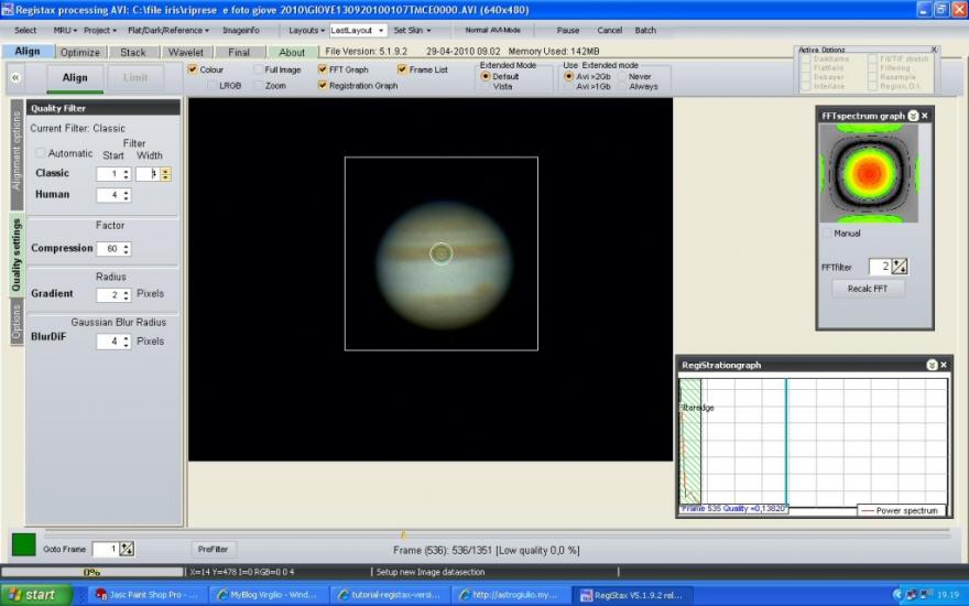

ADESSO CENTRATE USANDO IL BOX DI ALLINEAMENTO CHE VI COMPARE AVVICINANDOVI COL MOUSE SUL PIANETA,E CLICCATECI SU,
VI COMPARE ALLA FINE UNA FINESTRA COME QUESTA:
Allegato 4580
INITO QUESTO PROCEDIMENTO,POTETE VEDERE CHE OLTRE AD COMPARIRE SULLA FINESTRA FFT SPECTRUM (VEDI FOTO SOPRA), UN IMMAGINE A FALSI COLORI, NELLA FINESTRA REGISTRATIONGRAPH COMPARIRA UN GRAFICO DI COLORE ROSSO,PIU' SOTTO VI SPIEGHERO' A COSA SERVE PRECISAMENTE IL GRAFICO ROSSO SULLA FINESTRA REGISTRATIONGRAPH,INTANTO RIPRENDIAMO IL DISCORSO LASCIATO IN SOSPESO PRIMA,CIOE' A COSA SERVE IL SECONDO PARAMETRO (QUALITY SETTINGS),COME POTETE VEDERE QUI SOTTO REGISTAX METTE A DISPOSIZIONE UNA SERIE DI PARAMETRI PER L'ELABORAZIONE DELLE IMMAGINI,(CLASSIC,HUMAN,COMPRESS,LOCAL CONTRAST,GRADIENT,GRADIENT2,BLURDIF).
I METODI CHE USO SEMPRE IO E O CLASSIC,O HUMAN,GLI ALTRI PARAMETRI NON LI HO MAI USATI,PER CUI POTETE A VOSTRO PIACIMENTO PROVARE A IMPOSTARE ANCHE GLI ALTRI PARAMETRI,E VEDERE CHE RISULTATI OTTENETE.
IN QUESTO TUTORIAL HO USATO IL METODO CLASSIC.
Allegato 4581

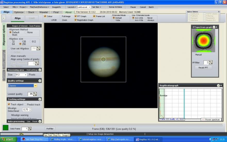

SEMPRE IN QUESTO PARAMETRO, DOBBIAMO IMPOSTARE NELLA FINESTRA (LOWEST QUALITY),LA PERCENTUALE OTTIMALE.QUESTO PARAMENTRO INFATTI SERVE A REGISTAX PER SCEGLIERE LA PERCENTUALE DEI MIGLIORI FRAME A PARTIRE DAL PRIMO FRAME MIGLIORE CHE ABIAMO SCELTO,PRIMA DEL PROCEDIMENTO DI ALLINEAMENTO.QUI POSSIAMO IMPOSTARE 60% O MENO,SE IL SEEING IN FASE DI RIPRESA E PROPRIO SCARSO,OPPURE TRA 80% O 90% SE IL SEEING E OTTIMO.(NELL'ESEMPIO LO IMPOSTATO A 75%). (VEDI SOTTO).
Allegato 4582
DESSO VEDIAMO COSA DOBBIAMO IMPOSTARE SUL TERZO PARAMETRO,(TRACKING SETTINGS),QUI POSSO DIRVI DI LASCIARE TUTTO
COME STA',CIOE' CON I PARAMETRI DI DEFAULT.(COME POTETE VEDERE NELL'IMMAGINE SOTTO CON LA SPUNTA SU TRACK OBJECT E 0,70
NELLA FINESTRA MISALIGN DETECTLEVEL).
Allegato 4583

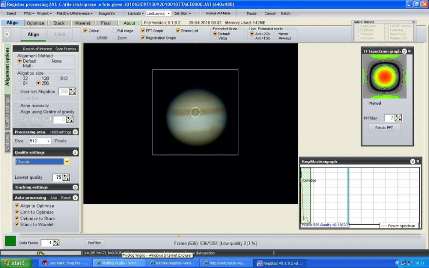

A QUESTO PUNTO VEDIAMO IL QUARTO E ULTIMO PARAMENTRO CHE DOBBIAMO IMPOSTARE,CIOE' (AUTO-PROCESSING),COME POTETE VEDERE NELL'IMMAGINE SOTTO SI DEVO SPUNTARE TUTTE LE IMPOSTAZIONI.
Allegato 4584

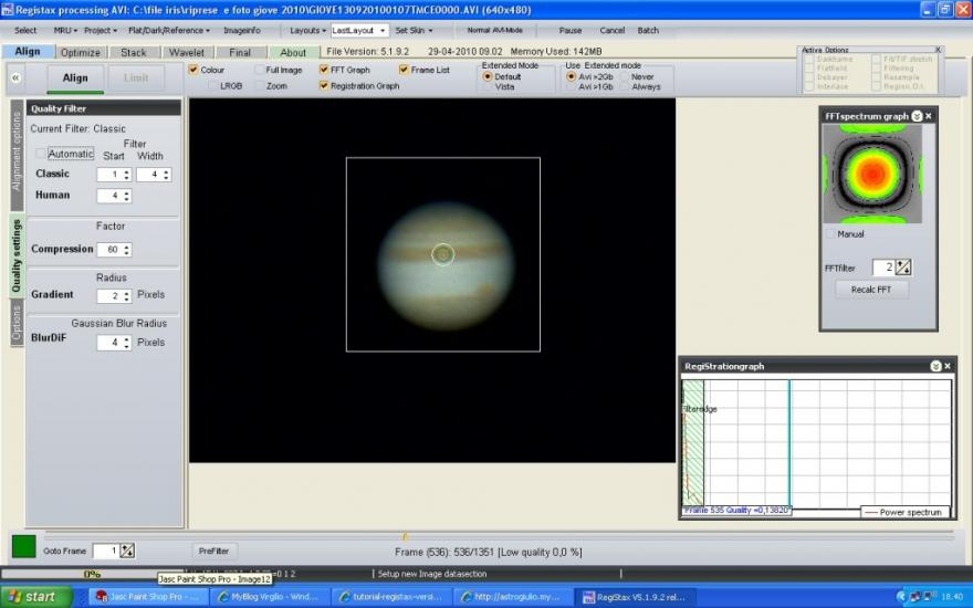

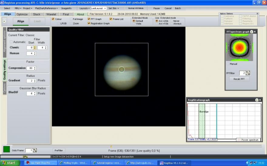

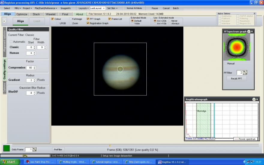

OGLIO RIPRENDERE QUI IL DISCORSO RIGUARDANTE IL PARAMETRO (QUALITY SETTINGS), E A COSA SERVE IL GRAFICO DI COLORE ROSSO COMPARSO SU REGISTRATIONGRAPH,(FINESTRA IN BASSO A DESTRA),CLICCANDO NELLA BARRA POSIZIONATA
IN VERTICALE A SINISTRA NEL CENTRO,(QUALITY SETTING),SI APRE UN RIQUADRO DOVE CI SONO UN PO' DI PARAMETRI,VEDIAMOLI UNO ALLA VOLTA.(VEDI FOTO SOTTO).
Allegato 4585
COME POTETE VEDERE A DESTRA SU QUALITY FILTER LE IMPOSTAZIONI SONO SU CLASSIC 1 A START E 4 A WIDTH,E SU HUMAN 4 A START.SOTTO SU COMPRESSION E IMPOSTATO SU 60,GRADIENT E IMPOTATO SU 2,INVECE BLURDIF E IMPOSTATO SU 4.
QUELLO CHE CI INTERESSA A NOI SONO LE IMPOSTAZIONI DA DARE SIA SU CLASSIC CHE SU HUMAN.
ADESSO VI SPIEGO A COSA SERVE LE FINESTRE START E WIDTH DI CLASSIC,PERO' DOBBIAMO RITORNARE SULLA FINESTRA REGISTRATIONGRAPH,IN BASSO A DESTRA,(NELLA FOTO SOPRA),SE VEDETE OLTRE A COMPARIRE UN GRAFICO ROSSO,C'E' ANCHE UNA FINESTRA DI COLORE VERDE A RIGHE,IL GRAFICO ROSSO INDICA L'ANDAMENDO DELLA SEQUENZA DEI FRAME,INVECE IL GRAFICO DI COLORE VERDE E UNA FINESTRA CHE POSSIAMO MODIFICARE CAMBIANDO SUI PARAMETRI DI CLASSIC (NELLA FINESTRA DI DESTRA
QUALITY FILTER) MODIFICANDO SIA START CHE WIDTH.
QUI SOTTO VI POSTO UN ESEMPIO:
Allegato 4586
IN QUESTO ESEMPIO SU CLASSIC HO IMPOSTATO 8 SU START LASCIANDO INVARIATO WIDTH,E SE VEDETE NELLA FINESTRA REGISTRATIONGRAPH LA FINESTRA DI COLORE VERDE A GRIGLIE SI E SPOSTATO A DESTRA.
VEDIAMO ORA COSA SUCCEDE SE MODIFICHIAMO ANCHE IL PARAMENTRO DI WIDTH:
Allegato 4587
COME SI PUO' NOTARE,MODIFICANDO WIDTH (QUI SOPRA IMPOSTATO A 9),LA FINESTRA VERDE SI E ALLARGATA.
A QUESTO PUNTO POSSIAMO DIRE CHE MODIFICANDO START LA FINESTRA VERDE SI SPOSTA,INVECE SE MODIFICHIAMO WIDTH
LA FINESTRA VERDE SI ALLARGA,A COSA SERVE TUTTO CIO' ,POTETE DIRE,SE VI RICORDATE SU REGISTRATIONGRAPH COMPARE UN
GRAFICO DI COLORE ROSSO,VEDI LA FOTO SOTTO),A QUESTO PUNTO TUTTO CIO' SERVE PERCHè DOBBIAMO FAR COMBACIARE LA FINESTRA DI COLORE VERDE GRIGLIATO,SUL GRAFICO ROSSO,IN MODO TALE CHE LA PARTE INIZIALE SI TROVI PROPRIO ALL'INIZIO DEL
GRAFICO ROSSO E LA PARTE FINALE APPENA IL GRAFICO ROSSO ARRIVI A FONDO SCALA.
RIPRENDENDO L'ESEMPIO,I PARAMETRI MIGLIORI SONO START IMPOSTATO A 1 E WIDTH IMPOSTATO A 4 (VEDI FOTO SOTTO).
Allegato 4588

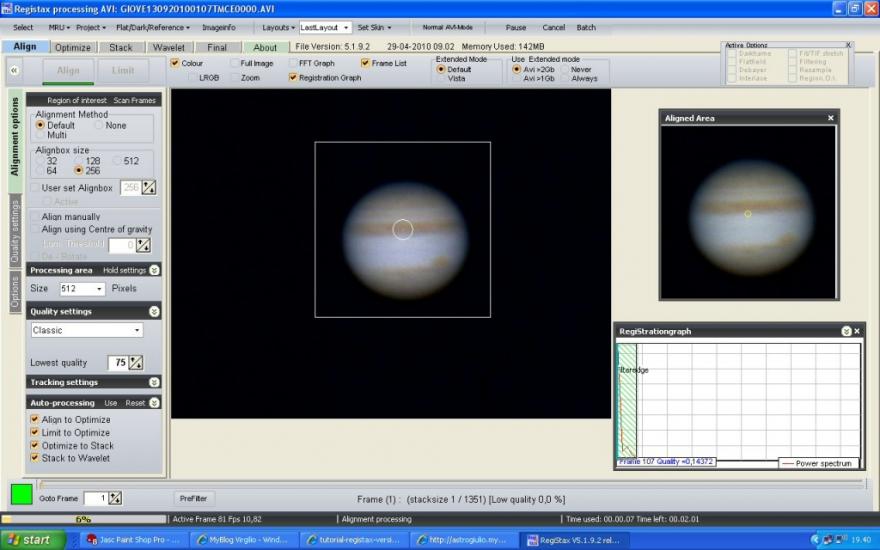

A QUESTO PUNTO RITORNATE SU ALINGMENT OPTIONS E CLICCATE SU ALING.
QUESTA OPZIONE FA FARE A REGISTAX UNA SCANSIONE DI TUTTI FRAME PARTENDO DAL FRAME SELEZIONATO,ALLA FINE DI QUESTO PROCEDURA,REGISTAX HA MESSO IN ORDINE TUTTI I FRAME SCANSIONATI DAL MIGLIORE AL PEGGIORE,COME POTETE VEDERE NELLA BARRA IN BASSO,SE SPOSTATE IL CURSORE GIALLO,I FRAME SONO NUMERATI DIVERSAMENTE E NON PIU'
IN ORDINE,QUESTO SIGNIFICA CHE ADESSO ABBIAMO TUTTI I FRAME GIA MESSI IN ORDINE DAL MIGLIORE AL PEGGIORE,ADESSO POSSIAMO CLICCARE SU ALING.
REGISTAX INIZIA COSI' AD ALLINEARE TUTTI I FRAME,PARTENDO DAL PRIMO FRAME CHE ABBIAMO SCELTO,(IN QUESTO CASO IL FRAME 536).
POTETE VEDERE IL PROCESSO DI ALLINEAMENTO NELLA BARRA IN BASSO A SINISTRA IN PERCENTUALE,COME DIMOSTRA LA FOTO QUI SOTTO,SE NOTATE IN BASSO A SINISTRA SOPRA START SI TROVA AL 6%.

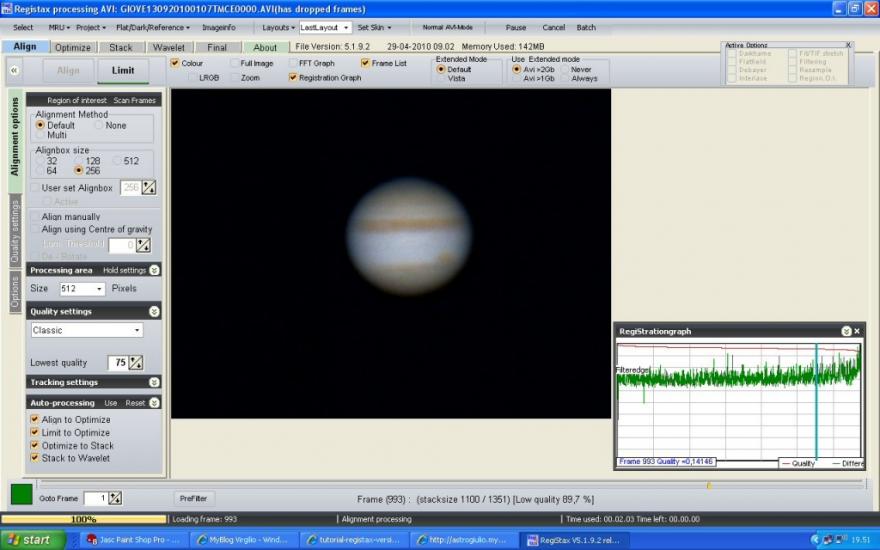

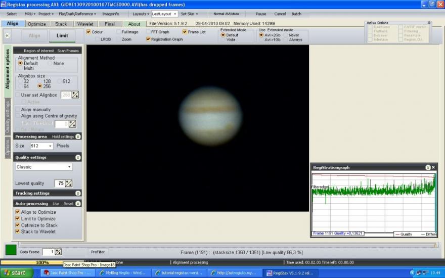

Alla fine del processo di allineamento,registax vi mostra un riquadro come questo:
Allegato 4590
qui gia possiamo sapere molte cose.
L'andamento del grafico nella finestra (registrationgraph),fa vedere l'andamento dei migliori frame,scelti da registax
in base al primo frame che abbiamo scelto noi all'inizio.
Nella barra in basso,si vede anche che il cursore e posizionato sul frame numero 1350(vedi foto sopra),a partire da qui tutti i frame che si trovano a sinistra del cursore sono i migliori,tutti quelli a destra i peggiori.
Sotto questa barra sempre al centro c'e' la scritta (stacksize 1350/1351) low quality 86,3%, significa che tra tutti
i 1351 frame,sono stati selezionati solamente i migliori 1350,e che la qualita e del 86%.
Giunti fino a qui,si puo' decidere se si vuole elaborare tutti i 1350 frame oppure selezionarli ancora,spostando il
cursore giallo a sinista.
Come potete vedere nella foto sotto,ho scelto di elaborare solamente 1100 frame.
Allegato 4591
il risultato dell'ulteriore selezione,oltre ad aver diminuito i frame da elaborare,ho ottenuto anche un miglioramento
della qualita',infatti se leggete in basso al centro (guardate la foto di sopra), su low quality non e' piu' il 86,3% ma e aumentato al 89,7%,un buonissimo risultato.

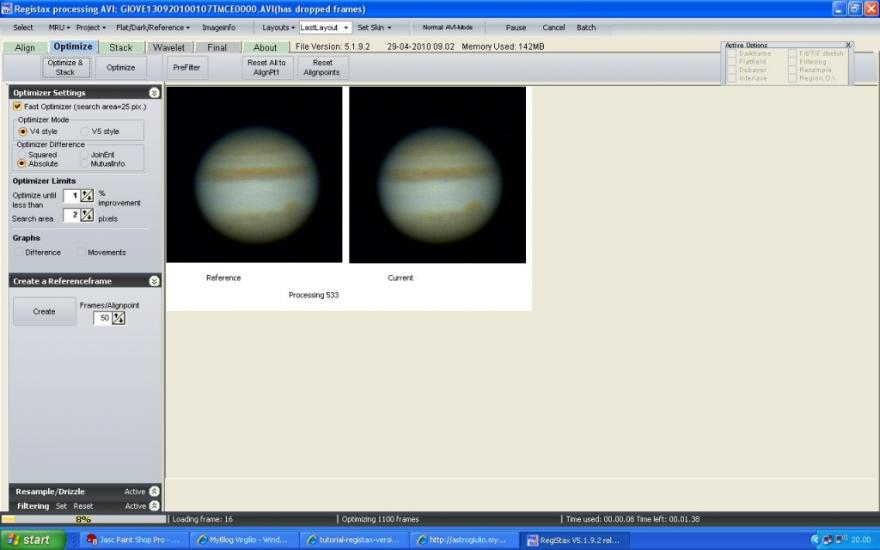

Dopo aver impostato questi valori,cliccate in alto a sinistra su optimize & stack,vi comparira la finestra seguente:
Allegato 4593
qui registax ha iniziato a fare l'ottimizzazione dei 1100 frame,possiamo vedere il processo guardando le due immagini
sullo schermo , l'immagine di destra con scritto reference,e quella di riferimento,invece l'altra con scritto current,e l'immangine che sta elbaborando.
Abbiamo anche la possibilita' di seguire l'andamento del processo in percentuale,vedendo la barra sotto a sinistra,
sopra start.(nel esempio,della foto di sopra si trova al 8%).

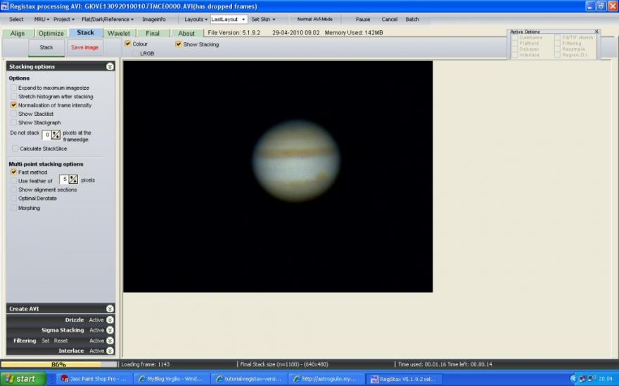

Quando finisce la fasa di ottimizzazione,registax inizia subito la fase di stack,come si puo' vedere nella foto seguente:
Allegato 4594
qui si trova gia al 86% dell'elaborazione.

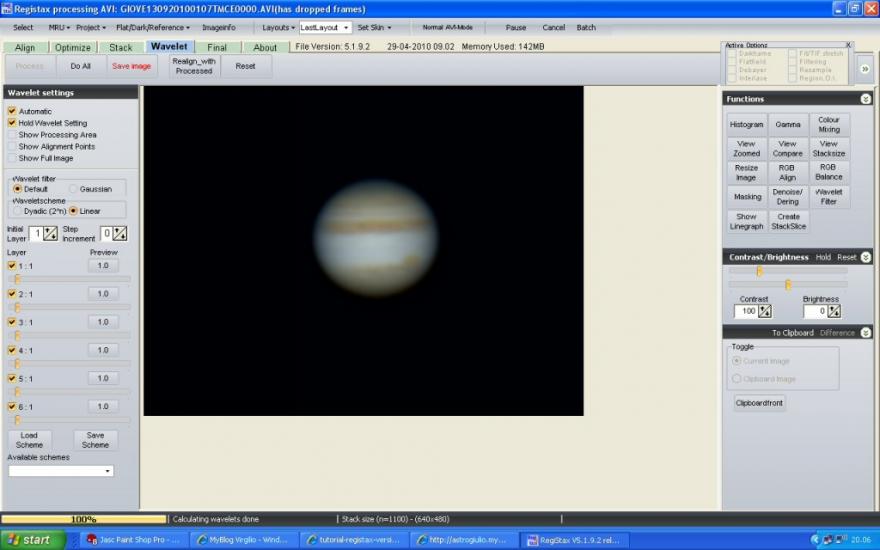

Dopo aver finito questo passagio,registax vi porta direttamente alla fase successiva(l'elaborazione con i wavelet)
Allegato 4595

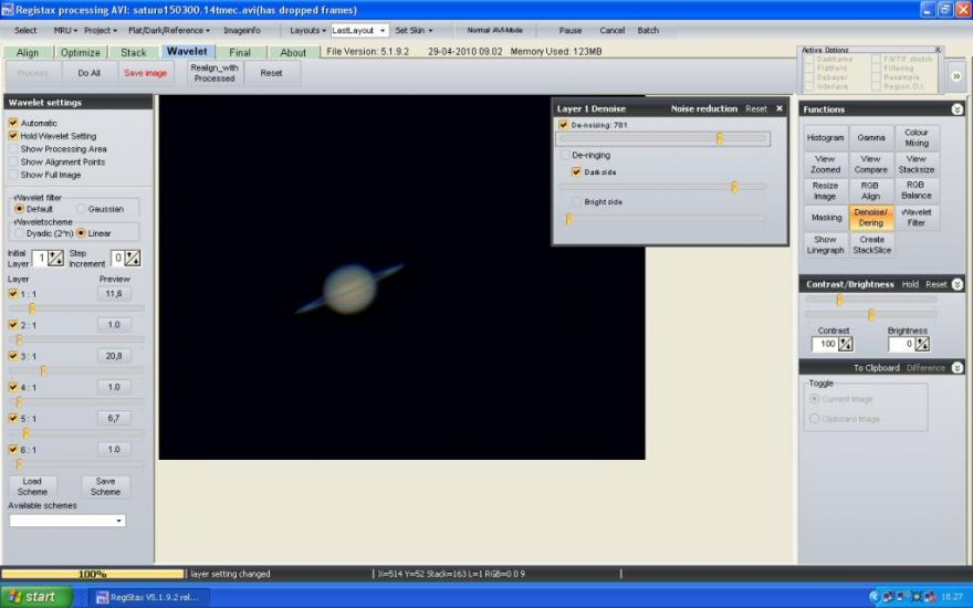

n questo riquadro,a destra troviamo i comandi dei livelli,ne sono sei,i primi due evidenziano o sopprimono i dettagli
piu' fini (come i pixel rumorosi),mentre agendo sui livelli 5 e 6 si evidenziano o sopprimono i dettagli molto piu' grandi.
Un mio consiglo,come faccio sempre io,e quello di iniziare a spostare il livello 3 o 4 per vedere quali dettagli si iniziano a vedere,ma questo e solo un suggerimento.
Secondo il tipo di ripresa ed elaborazione,si devono usare i livelli giusti,fino ad ottenere un immagine buona,riprendendo l'esempio dimostrativo,come si puo' vedere nella foto seguente,ho spostato solamente tre livelli:

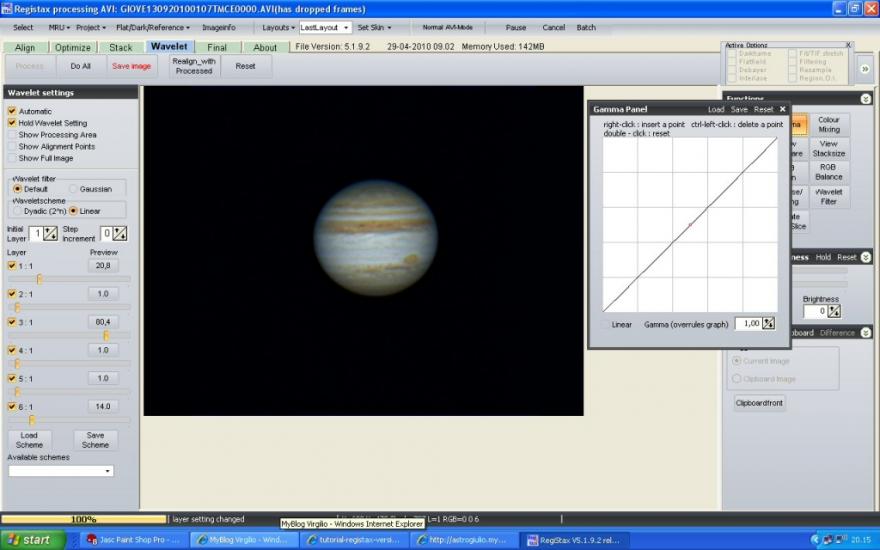

Allegato 4596
il livello 1 portandolo a 20,8,il livello 3 portandolo a 80,4,e il livello 6 portandolo a 14,0.(come si puo' gia notare,
giove e pieno di particolari).

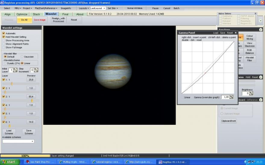

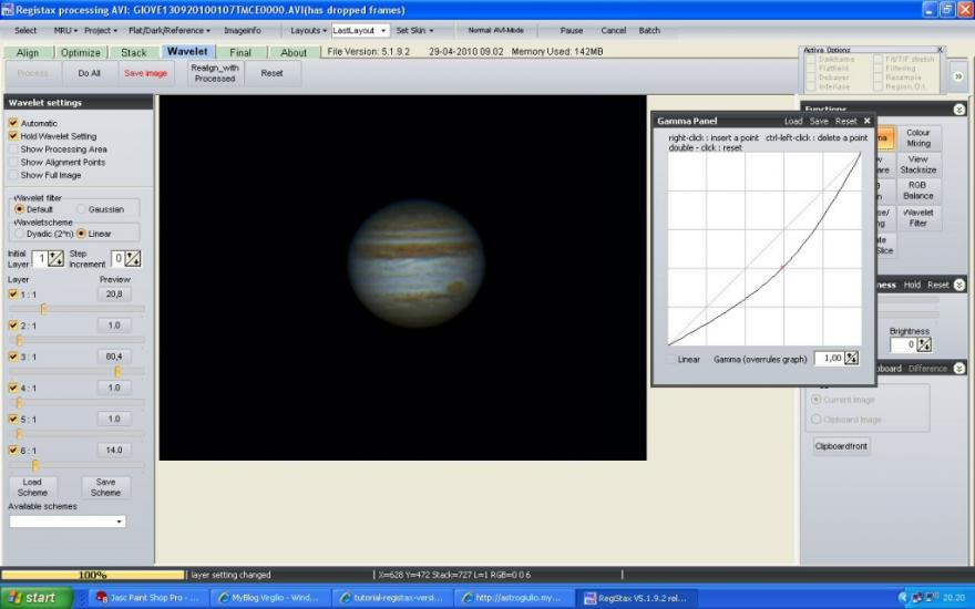

La fase successiva a questo punto e quello di andare ad aprire la finestra del gamma,si trova nella parte destra
in alto,nella tendina functions,in mezzo a histogram e colour mixing,cliccateci su,si aprira questa finestra:
Allegato 4597
(continua).
Allegati: 7
Re: introduzione all'uso di registax 5
QUESTO FILTRO, A PRIMA VISTA, SEMBRA CHE AUMENTANDOLO, L'IMMAGINE DIVENTA PIU' LUMINOSA,INVECE DIMINUENDOLO DIVENTA PIU' SCURA.
IN REALTA' LA FUNZIONE GAMMA AGISCE IN MANIERA MOLTO PIU' SOTTILE,PER ESEMPIO SE PROVATE A UTILIZZARE LA FUNZIONE GAMMA
DI UN QUALUNQUE SOFTWARE PER L'IMAGE-PROCESSING COME PHOTOSHOP,NOTERETE CHE LE PARTI DELL'IMMAGINE PIU' LUMINOSE E PIU' SCURE RESTANO INALTERATE,MENTRE LA LUMINOSITA' DELLE ZONE INTERMEDIE VARIA NOTEVOLMENTE.
UN ALTRO GRANDE VANTAGGIO DELLA RIDUZIONE DEL GAMMA (COMBINATA CON UN MASCHERA SFOCATA O UN TRATTAMENTO WAVELET)
STA NEL FATTO CHE SI PUO' OTTENERE IL MASSIMO CONTRASTO SUI DETTAGLI FINI SENZA CHE IL BORDO PLANETARIO VENCA CANCELLATO O L'EQUATORE PLANETARIO VENGA SOVRAESPOSTO.

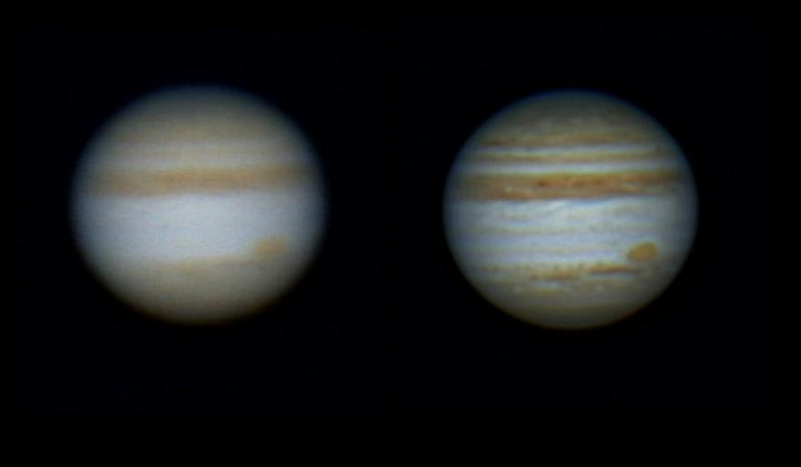

(PER FAR CAPIRE MEGLIO LA FUNZIONE DEL GAMMA, HO MESSO QUI SOTTO DUE FOTO CON DIFFERENTI INPOSTAZIONI)
QUESTA PRIMA FOTO SOTTO E LA BASE DI PARTENZA,SENZA NESSUNA MODIFICA.
Allegato 4598
LA FOTO SEGUENTE INVECE E IL RISULTATO,DOPO AVER SPOSATO DI PARECCHIO IL GAMMA,(COME SI PUO' ANCHE VEDERE DALLA FINESTRA A DESTRA).
Allegato 4599
NATURALMENTE IL GAMMA DELLA FOTO SOPRA E STATO SPOSTATO ESAGERATAMENTE,MA SE CONFRONTATE LE DUE IMMAGINI,NOTERETE CHE SENZA USARE IL GAMMA L'IMMAGINE E SI PIU' LUMINOSA MA LE BANDE SONO MENO CONTRASTATE,IN CONFRONTO ALL'IMMAGINE
CON L'USO DEL GAMMA,(SI E' PIU' SCURO,MA SIA LE BANDE CHE LA MACCHIA ROSSA E PIU' EVIDENTE),NATURALMENTE PER
FARVI CAPIRE LA FUNZIONALITA' DEL GAMMA HO VOLUTO ESAGERATAMENTE AUMENTARLO,MA SI DEVE SEMPRE TROVARE UN BUON COMPROMESSO, ANCHE USANDO QUESTO FILTRO.

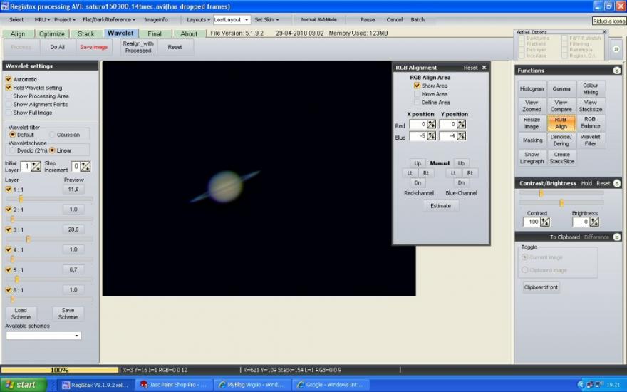

DOPO AVER SETTATO ANCHE IL GAMMA,DOBBIAMO ANDARE A CLICCARE SU DO ALL (QUESTO E' IMPORTANTE,NO DIMENTICARVI MAI DI FARLO COME SI VEDE IN QUESTA FOTO (COLORATO IN GIALLO).
Allegato 4600

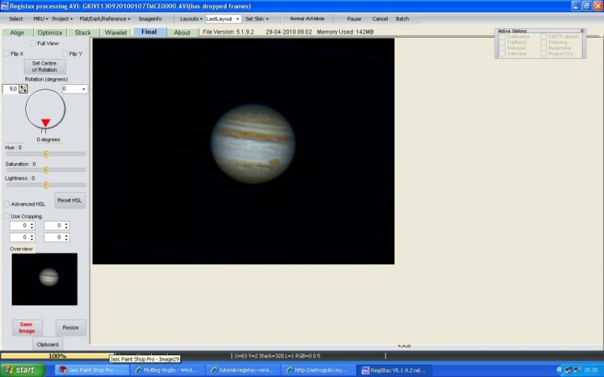

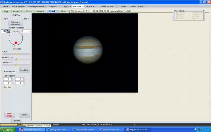

ORA DOBBIAMO ANDARE A CLICCARE SU FINAL IN ALTO AL CENTRO,UN PO' SPOSTATO A SINISTRA.
COME SI VEDE NELLA FOTO CHE SEGUE E DI COLORE BLU.
Allegato 4601
QUI LA FUNZIONE CHE PIU' CI INTERESSA E LA POSSIBILITA' DI POTER RUOTARE L'IMMAGINE,PER FARE CIO' REGISTAX CI DA DUE
POSSIBILITA',SE VEDETE A DESTRA UN PO' IN ALTO C'E' UN CERCHIO COL TRIANGOLO ROSSO,QUESTO E LA PRIMA SCELTA,
PERO' PER SPOSTAMENTI PICCOLI QUESTO SISTEMA E UN PO' DIFFICILE,PER CUI UN ALTRO SISTEMA E IL SEGUENTE,SOPRA IL CERCHIO
CI SONO DUE CURSORI UNO A DESTRA E UNO A SINISTRA,CLICCANDO SULLE FRECCE DI OGNI CURSORE SI HA UNO SPOSTAMENTO PICCOLO,QUESTO E MOLTO UTILE PER I MICRO SPOSTAMENTI.
COME ESEMPIO SI PUO' VEDERE NELLA FOTO SOTTO DOVE HO USATO SOLAMENTE IL CURSORE DI SINISTRA,PORTANDOLO DA 0 (IMPOSTAZIONE INIZIALE) A 9.
Allegato 4602

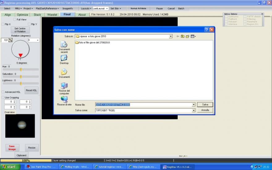

QUESTO PUNTO ABBIAMO FINITO LA NOSTRA ELABORAZIONE,E NO CI RESTA CHE SALVARE IL TUTTO,ANDANDO A CLICCARE SU SAVE
IMAGE IN BASSO A SINISTRA,SOPRA START,COME DIMOSTRA LA FOTO SEGUENTE.
Allegato 4603
IL MIO CONSIGLIO E QUELLO DI SALVARE IL TUTTO IN TIFF A 16 BIT RGB,POI SI PUO' SEMPRE MODIFICARLO,SALVANDOLO IN ALTRI FORMATI.

Proprio per aiutare molti all'uso di questi programmi di elaborazione.
Ciao.

Qui vi posto alcuni aggiornamenti sempre riguardante registax 5.
QUESTA OPZIONE MOLTO IMPORTANTE, LO SCOPERTO DA POCO,SAREBBE UN PASSO DA FARE,PRIMA CHE SI CLICCA SU ALING,PER FARGLI FARE L'ALLINEAMENTO DEI FRAME. SAREBBE QUELLO DI CLICCARE SU SCAN FRAME (VEDI FOTO SOTTO CERCHIATO DI BIANCO).
Allegato 4616
QUESTA OPZIONE FA FARE A REGISTAX UNA SCANSIONE DI TUTTI I FRAME (NATURALMENTE PARTENDO SEMPRE DAL MIGLIOR FRAME CHE ABBIAMO SELEZIONATO ALL'INIZIO),E ALLA FINE DELLA SCANSIONE LI METTE IN ORDINE DAL MIGLIOR FRAME AL PEGGIORE, A QUESTO PUNTO PROSEGUITE SEGUENDO IL TUTORIAL NEL PUNTO DOVE DICE DI CLICCARE SU ALING, E PROSEGUIRE FINO IN FONDO.
HO LETTO SU ALCUNI FORUM CHE REGISTAX NON SUPPORTAVA FILE DA 2 GB O MAGGIORI IN QUESTA VERSIONE LA SITUAZIONE E' STATA AGGIORNATA,PER CUI SI PUO' USARE FILE DA 2 GB O MAGGIORE,BASTA SELEZIONARE NEL RIQUADRO IN ALTO A DESTRA (DOVE C'E' SCRITTO USE EXTENDED MODE), AVI >2 GB,COME ESEMPIO VEDETE LA FOTO CHE POSTO QUI SOTTO DOVE LO EVIDENZIATO CON UN CERCHIO.
Allegato 4617
UN ALTRA OPZIONE INTERESSANTE, CHE SI PUO' USARE ALLA FINE DEL PROCESSO DI ALLINEAMENTO ,STACK E OPTIMIZE,QUANDO CI TROVIAMO NELLA FINESTRA DEI WAVELET,E' L'OPZIONE DENOIS/DERING.QUESTA OPZIONE CHE TROVIAMO NELLA FINESTRA FUNCTIONS,CHE NELLA FOTO QUI SOTTO SI PUO' VEDERE DI COLORE GIALLO A DESTRA, CLICCANDOCI SOPRA,SI APRE UNA FINESTRA COME QUELLA CHE SI VEDE SEMPRE NELLA STESSA FOTO.QUI CI SONO TRE PARAMETRI,SELEZIONADO UNO DI QUESTI PARAMETRI O TUTTI E TRE,E SPOSTANDO I CURSORI DA SINISTRA A DESTRA,SI ELIMINANO ALCUNI ERRORI COME ANTIESTETICI PUNTINI O ALTRE IMPERFEZIONI,E OTTENERE UN IMMAGINE PIU' SOFT.PER FARE UN ESEMPIO SI AVVICINA UN PO' AL OPZIONE NOISE NINJA DI PHOTOSHOP.
Allegato 4618
PUO' CAPITARE,CHE ALLA FINE DELLA SOMMA,ED ELABORAZIONE DEI VARI FRAME CI TROVIAMO UN IMMAGINE DEL PIANETA CON DEI COLORI NON ALLINEATI, MOLTO BENE,SI PUO' RIMEDIARE SEMPRE ALLA FINE QUANDO CI TROVIAMO NELLLA FINESTRA DEI WAVELET. SEMPRE NELLA FINESTRA FUNCTION C'E' L'OPZIONE RGB ALIGN (EVIDENZIATO NELLA FOTO QUI SOTTO DI COLORE GIALLO),CLICCANDOCI SU, SI APRE UNA FINESTRA (COME SI VEDE SEMPE NELLA FOTO SOTTO),QUI CI SONO 2 OPZIONI,HO USARE LE FRECCE IN MODO MANUALE,OPPURE USARE LE FINESTRE X POSITION Y POSITION,DOVE METTERE I VARI PARAMETRI PER SPOSTARE GLI ASSI PER CORREGERE E RIALLINEARE I COLORI.(SOPRA NELLA STESSA FINESTRA CI SONO TRE OPZIONI SHOW AREA,MOVE AREA,DEFINE AREA,SELEZIONADO UNA DI QUESTE OPZIONI O TUTTI E TRE SI OTTENGONO DIVERESE MODIFICHE PER RIALLINEARE O CORREGERE I DIVERSI COLORI O DOMINANTI,NATURALMENTE SI DEVE PROCEDERE SEMPRE PER TENTATIVI,FINI A QUANDO SI OTTIENE UN IMMAGINE ABBASTANZA BILANCIATA).
Allegato 4619
Sperando che anche questi aggiornamenti e vi posso essere utile,vi saluto, ciao :)
