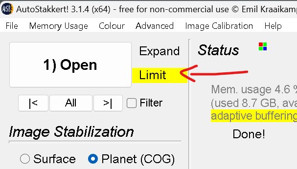

    "Here's a tip for evaluating and optimizing your capture files when they don't line up with seeing:
    1. here are two 120 second captures opened in AS!3. From the quality graph we can see the seeing was best the second half of the first capture, and the first half of the second capture.
    2. open both in PIPP and choose Join mode and output as a single video file (avi or ser)
    3. open the joined video in AS!3 and analyze, we can see the best seeing right in the middle, as expected
    4. , hold down shift key and click-drag from the start of the best seeing to the end and then lift up your mouse. this will set the processing frame limits of your video to this section.
    5. click Analyze and proceed, but know that you have the best seeing from both captures, so you can probably increase your frame percentage to stack. in this case I chose 75%
    5. remember to reset the limit in AS!3 for future captures by clicking the limit and choosing disable" Brian Finn Valente
